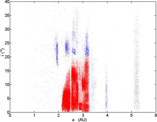

For example this graph representing the centaurs, the Kuipier belt and scattered disc objects show that most objects are around the same plane, with few objects with more than 30 degrees of inclination:
Centaurs, Kuipier belt and Scattered disc representation
This is the inclination of the asteroids:
Asteroids inclinations
Again, few have more than 30 degrees of inclination.
