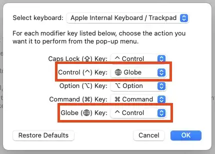

I'm a new Mac user so I don't know much about how this was solved before. But this seems to be fixed in MacOs Monterey 12.5 (MacBook Pro 16'' 2021). No third application required :)
Keyboard preferences
