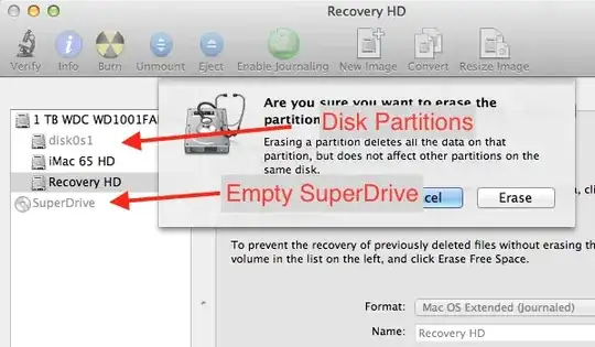

Now, since you said that you were able to go into disk utility, you already know how to boot into Recovery Mode. What I am assuming you saw when you were working in Disk Utility is something similar to this:
The SuperDrive being greyed out is probably because the drive is empty. disk0 is typically the disk drive in your Mac. Mac OS X Base System is more than likely a partition on disk0
Do this:
Hold down the Option while powering on your Mac. If there is a bootable partition, it will be listed (other than the recovery partition). If so, boot into it.
Once you have booted, check to see what you have selected as your startup disk (Preferences --> Startup Disk)
