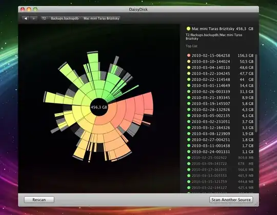

You can try :
Studer
  • 8,779
  • 38
  • 38
    +1 for DaisyDisk. You don't even technically need to pay for it, just endure the 10-second nag on startup. – Kyle Cronin Aug 30 '10 at 18:23
  • Or won it through MacHeist ;) – Studer Aug 30 '10 at 18:47
  • DaisyDisk is brilliant! +1 – conorgriffin Jan 31 '11 at 22:41
  • DaisyDisk took one of the views that WhatSize uses and made a very nice update. The app store version won't look at files as an administrator (root) or clean things out - so you might look for another tool if you want a cleaner / duplicate file finder. It does do pictures the best of any. – bmike Jul 20 '11 at 21:22
