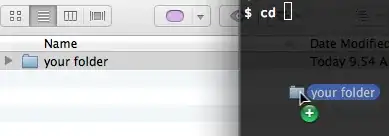

Use pax. The default pax format, called ustar, preserves file modification and access times (among other things like user ID, group ID, file mode bits and extended attributes like Spotlight comments and ACLs). See pax man page here for more details.
First, create a pax archive on every Mac and copy it to the external hard drive like this:
  1. Open Applications>Utilities>Terminal.
  2. Type in Terminal:
    $ cd
    and drag the folder where the files to be combined reside on that Mac to Terminal:
    Alternatively you can type the full folder name:
    $ cd /path/to/your\ folder
    This will change the current folder to 'your folder'.
