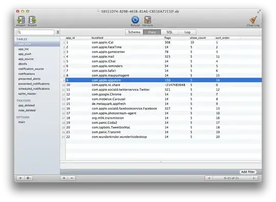

There is a SQLite database located at ~/Library/Application Support/NotificationCenter that looks to house all the information for registered Apps in Notification Center.
The Mac App Store does have some entries in the DB, but I don't see anything that would allow you to change the settings. Perhaps someone with more knowledge could poke around and find out more.

ckoerner was on the right path. This is a bit technical, but I've been blessedly free from the 10.8.3 update notice all day.
  1. Go to ~/Library/Application Support/NotificationCenter
  2. Figure out which .db file is the newest.
  3. Open that file in Terminal with sqlite3: sqlite3 LONG_FILE_NAME.db
  4. Type select app_id from app_info where bundleid = 'com.apple.appstore'; and then hit return. A number will be displayed.
  5. Then delete all the notifications from the app store. delete from notifications where app_id = NUMBER_FROM_PREVIOUS_STEP;
  6. Finally, you might need to kill NotificationCenter. That was the only way to remove an existing notification off the screen. Type killall NotificationCenter in Terminal.
Here is an example of using sqlite3:
sqlite> select app_id from app_info where bundleid = 'com.apple.appstore';
sqlite> delete from notifications where app_id = 8;
sqlite> .q
I'm not sure how long it will last, but it has been a great afternoon without that notification nagging me all day.
