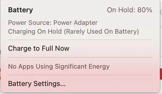

I'm trying to stop my MacBook Air M1, 2020 with macOS 13.5.1 from sleeping on power adapter.
I've tried "prevent automatic sleeping on power adapter when the display is off" as stated in a tutorial
I already turned display off to never.
pmset command
I've also tried the command sudo pmset -a disablesleep 1 as stated in a stackexchange answer
battery settings
question
it still goes to sleep each time about two hours after I leave it idle On Hold, lid open, no matter it's day or night, how do I do?

  • @Alper “idle On Hold” means power adapter, i didn't lock the screen, it locks itself – JJJohn Sep 24 '23 at 14:30
    Thx for the update. So you leave the MBA idle with the lid open and connected to power with the above settings and it regularly goes to sleep in about two hours, day or night? Is this accurate? How do you figure out the MBA goes to sleep rather than only the screen being turned off? Can you include a screenshot of the Options in System Settings>Battery>Options in your question? – Alper Sep 24 '23 at 15:40
