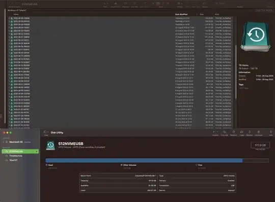

The Pic shows the Source Drive (512NVMEUSB and the Destination TimeMachine

Before macOS 11 (Big Sur) Time Machine used HFS+ formatted disks. Whilst not easy it was possible to copy TM backups to a new HFS+ formatted disk. See some of the "related" links in the side bar.
This question and answer Is it possible to copy an entire APFS format Time Machine disk to another drive under Monterey?, suggests that it is possible but unpractical to copy APFS Time Machine drives. From the discussion following the answer, I have doubts that it is possible.
For practical purposes, copying an entire Time Machine disk to a new Time Machine disk is impossible.
Glenn Fleishman agrees with this, see https://www.macworld.com/article/609296/cant-directly-copy-time-machine-backups.html. His solutions are to either keep the old drive on the shelf or to copy selected folders (or all folders) from selected backup dates to a non-TM disk.
I strongly recommend that:
  1. You put the existing Time Machine to one side. Keep it in case you find the need to restore something. When you are confident you won't need the backup, reformat and reuse the disk for other purposes.
  2. You start again with Time Machine on the new disk.
For encryption, there is no point in encrypting the disk in Disk Utility as Time Machine will create a new volume (or replace one you specify). Tell Time Machine to enable encryption.
