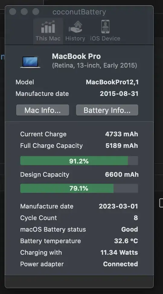

So as mentioned in my last post I got a new battery. It is not even a week and Coconut Battery tells this design capacity, around 79%. Is it normal or there is some issue in the battery? I run the following command and it returns the below:
ioreg -brc AppleSmartBattery

  • Contact the vendor who supplied this battery and request a replacement, or at least an explanation. Unfortunately, unscrupulous vendors will sell "as new" batteries pulled from used systems. – da4 Aug 24 '23 at 13:40
  • It’s a defective battery. It could be NOS (New, Old Stock) where it sat around for years degrading or just a poor quality build. Either way, you need to return it. – Allan Aug 24 '23 at 14:10
  • @Allan what should I say to him when returning? and what should I check while having another? – Volatil3 Aug 24 '23 at 15:57
  • Let your supplier know that it failed out of the box and won’t hold a charge. That’s the truth. As for what to look for, in one of the linked dupes I reference some things to look for (like an 18 month or better warranty). However, the first thing you should check for is a manufacturing date. Anything over a year old should be skipped. – Allan Aug 24 '23 at 15:59
  • @Allan as per the sshot, it says it was manufactured on 1st march. – Volatil3 Aug 24 '23 at 16:01
    That’s data written to the battery controller. Look for a date code imprinted on the battery itself. But, keep in mind, these are devices that rely on a chemical reaction to produce electrons. You could easily get a defective battery manufactured just yesterday as well. – Allan Aug 24 '23 at 16:02
  • @Allan in short it's all about luck. – Volatil3 Aug 24 '23 at 16:04
    Buy from Ali Expess < luck. Buy genuine Apple or batteries made from LG/Panasonic cells > Luck. “Luck” plays a part, but much less so from reputable manufacturers/vendors. Even Apple will ship out a faulty battery in a new Mac from time to time. – Allan Aug 24 '23 at 16:07
