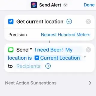

In short, you can’t reconfigure SOS to not contact your local emergency services. This is by design and hard coded into your phone.
However, you can set up an Accessibility shortcut triggered by either a double or triple tap of the back of the phone. This will trigger an action like sending out a text message to a group of people that you need assistance.
You can find the “Back Tap” under Settings → Accessibility → Touch → Back Tap
You will find a number of actions under Double and Triple Tap. However, you’ll need to create a simple shortcut for this:
  1. Create a new shortuct
  2. Select “Get Current Location”. Be certain to allow the app to use your precise location
  3. Select “Send a Message” Action. Enter your text and add the “Current Location” variable.
  4. Type a short canned message: “I’ve crashed into the sofa, send beer!”
  5. Enter your receipients
  6. Save and attach to Accessibility Shortcut (see above)
Send Help Shortcut w/ Location
It’s a simple two action shortcut - it doesn’t need to be overly complex, but you can customize as necessary. The beauty with a Shortcut like this is not only can you “attach” it to an action like double/triple tap, but you can use Siri to activiate it as well.

    Great idea, however I found it relatively easy to accidentally activate the back tap shortcut. You may want to show a timed "cancel" button or some other kind of timeout-positive confirmation (if possible), othervise you may randomly alert your relatives whenever you drop your phone or accidentally tap your pocket. – Neinstein Jul 11 '23 at 13:29
    @Neinstein "I found it relatively easy to accidentally activate the back tap shortcut" - You'll be getting a lot of beer. – Vanity Slug - codidact.com Jul 12 '23 at 16:56
    @VanitySlug-codidact.com either that or turning into the boy who cried wolf – Luke Sawczak Jul 12 '23 at 22:57
