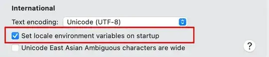

The answer in https://apple.stackexchange.com/a/21107/237 is the correct one.
You have this turned off: enter image description here
Marc Wilson
  • 5,920
    Thanks! However what's happening is rather the opposite. This setting was turned ON. After turning it off, the error disappears. So this does indeed solve the problem, I must have made a mistake when checking the comment by @mmmmmm . However, the problem, to a certain extent, is not fully solved. The difference in the new locale is that LC_CTYPE is set to UTF-8 and everything else is the same. Why does this create an error in man? – Kolja Nov 26 '22 at 22:36
