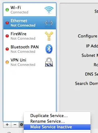

Idea
Does your iMac support wake on Airport network access? Newer Macs can wake up on both Airport and Ethernet access. This is then called "wake on network access" instead of "wake on ethernet/airport access".
If you iMac supports waking on Airport access, disable your Ethernet port. Maybe this will force the iMac to stay connected to the Wi-Fi during sleep and the 'bug' will not occur then.

  • @jmlumpkin I would try to make the ethernet port inactive in the system preferences. This will force your iMac to stay connected to Wi-Fi during sleep, i assume. Maybe this 'bug' will not occur then. – gentmatt Mar 22 '12 at 18:57
  • Wifi is actually turned off, I wonder if it wants it on. – jmlumpkin Mar 22 '12 at 18:59
  • @jmlumpkin How did your iMac locate itself earlier with Wi-Fi off? That seems inconsitant with what Apple says. – gentmatt Mar 22 '12 at 19:02
  • Because the machine was awake (I was at home and used it, then restarted it, used it again, then left). Also, I do know it does that 'wake on demand' feature, I remember looking through the system.log a while back to see it waking up oddly in the middle of the night. – jmlumpkin Mar 22 '12 at 19:12
  • The machine also consistently shows up in Finder on other Macs while at home. Wakes up if you click on it. – jmlumpkin Mar 22 '12 at 19:13
  • @jmlumpkin But does it connect to Wi-Fi? – gentmatt Mar 22 '12 at 19:14
  • No, the machine has always been hardwired. – jmlumpkin Mar 22 '12 at 19:15
  • Updated with the 'new update'. Will try a few other things (like actually this part, rather than my preferred way), and update. – jmlumpkin Mar 22 '12 at 23:23
    So I just tried the other way, and it looked like it may have worked! If so, I am not sure that I want to use Wifi vs Ethernet just for this feature to work while asleep. But I will submit a radar to Apple about the issue. – jmlumpkin Mar 23 '12 at 00:48
  • @jmlumpkin Great news! I'm glad that it (may have) worked. – gentmatt Mar 23 '12 at 06:30
  • well, I don't think it did, and I think its more related to my machine in general. When I went full wifi, it actually wouldn't wake up locally either. I think your answer is the most correct, it is my issue here (not waking), but I think its going to be much more troubleshooting (more than I want), on what actually is happening. If anything, I may stop even making the machine sleep, not much of a need anymore, and just sleep the display. – jmlumpkin Mar 23 '12 at 11:26
