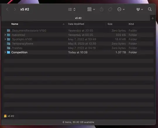

I have two external Samsung X5 2TB Thunderbolt 3 SSDs. Both of them work fine after I reformat them. But when I delete files (and empty the recycle bin), the space on them does not increase. In order to get space back, I need to empty it, reformat, then rebuild up files on it.
So far I have tried the following:
  1. Enabling TRIM. It's enabled, does nothing.
  2. Showing hidden files/folders to make sure nothing is hiding on the drive. There's nothing there, trash on the volume is empty, etc.
  3. I've tried running "First Aid" in Disk Utility. It runs fine and finishes but it doesn't fix the problem.
What could be causing this? I am running MacOS Monterey on an M1 Max laptop.
1.37TB of data but only 31GB free on a 2TB disk
File system thinks I am using 1.97TB
TRIM is enabled

  • Hi, did you check any of the solutions to similar questions? https://apple.stackexchange.com/q/362656/24324 https://apple.stackexchange.com/q/44203/24324 https://apple.stackexchange.com/q/378473/24324 – Saaru Lindestøkke May 12 '22 at 15:59
  • Yes I saw some of those but there are no local snapshots on these drives that I can find. Terminal doesn't find them either. Also those all say 24 hours, which it has been more than for the data in question. So it should have been purged by now either way. This has been going on through several cycles with these drives -- the only way to get the space back, that I can find, is to reformat them. – natarem May 12 '22 at 17:56
  • Hmm, strange. Could you perhaps include that kind of details in your question? It will help answerers in writing something that you haven't tried yet. What happens when, after you delete all files you try to write the full capacity? I assume it'll wrongly show the capacity, but I'm curious if it will actually stop you from writing. – Saaru Lindestøkke May 12 '22 at 22:23
  • I didn't check the local snapshots thing until I saw the other answer from @benwiggy. If I delete files and try to write the full capacity, it stops when it gets to the "fake" full capacity, it doesn't recognize the deleted space as being available. The only way to get access to that deleted space again is to do a disk format. I think I am going to try reformatting as exfat or something like that, apfs doesn't seem to work on these disks. – natarem May 13 '22 at 17:40

  • Thanks for the answer but this has been like this for over 24 hours and I just checked, there are no local snapshots on either one of my TB3 SSDs. – natarem May 12 '22 at 17:53
Just to update this, I tried reformatting as HFS and it does work to delete and recover space. I'm still not sure why APFS is jacked up on these particular Thunderbolt3 SSDs (the same problem is not happening on my internal SSD, other external SSDs, etc) but it doesn't work.
