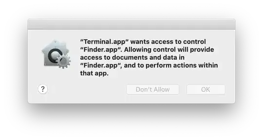

    • you may see this: enter image description here
      if so, click OK
  3. Your testfile.txt should now be gone from your pwd, and be in the Trash folder now.
