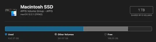

I clean installed macOS Monterey from a flash drive. I believe that at the time, the volume it was installed to was labeled Untitled. In any case, Startup Manager (reached from holding Option (⌥) at boot) now shows the Mac disk as "Untitled".
After the install, I used Disk Utility to set the standard names, "Macintosh HD" for the volume group and "Macintosh HD - Data" for the data volume, but Startup Manager still shows "Untitled". How do I rename the label in Startup Manager to the standard "Macintosh HD"?
