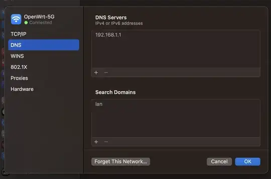

For me the solution was to remove all custom DNS Servers in the network settingsenter image description here
