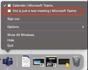

In MS Teams new meeting experience the meeting it self always opens in a separate window, which I'd like to make active via apple script to be able to thereafter trigger a shortcut.
That way I can be in any other app and execute this for hotkey commands to work.
The meeting window title will always be unique as it uses the meeting title. Can we in just tell it to switch to the second window via applescript (regardless off title)?
Test Meeting
EDIT 1:
I only managed to use AXRaise and cycle through the windows, but I need to always raise it and select the second window in the list. Is there another way or do i need to click the menu item somehow and use arrow key down?

I do not have Microsoft Teams, so I cannot test the example AppleScript code show below, however it works on the other applications I tested it on.
Based on the screenshot in the OP, assuming you want to actuate the menu of a Dock Tile and click a menu item, then here is a way to do it.
Example AppleScript code:
tell application "System Events"
    tell UI element "Microsoft Teams" of list 1 of application process "Dock"
        perform action "AXShowMenu"
        delay 0.1
        click menu item 2 of menu 1
    end tell
end tell

  • Thanks, both unfortunately do the same as the code I posted, cycling through each window each time i execute it instead of targeting only the same 2nd window each time.
    When executing it once reveals the main MS Teams window and next time the meeting window etc. , back and forth. Unfortunately the hotkey only works in the meeting window.
    – Markus Oct 13 '21 at 13:33
  • Brilliant thanks that worked, thought that this may be the only way, just didn't know how to for dock items, just menu bar, learned some cheers (for coming back with updated answer). – Markus Oct 13 '21 at 14:08
  • I edited my post in case there is another way without visually going through the dock men, which would be better, since once I executed it and are active in the window i no longer need to use it for triggering the hotkey. Unless alternatively there is an if condition i can use to only trigger it if that window is not already active? Doubt that since that relies on targeting that 2nd window in the first place right? Or if I can set a variable or index so this can be checked the second time I execute it...? – Markus Oct 13 '21 at 14:34
  • FYI I figured out a better solution that I added here using the app main menu. I'll leave your solution as accepted since you put in the effort and it works. My image in the OP was more for illustration rather than explicit solution, but glad we found two ways and one that works better, learned some. – Markus Oct 14 '21 at 12:35
