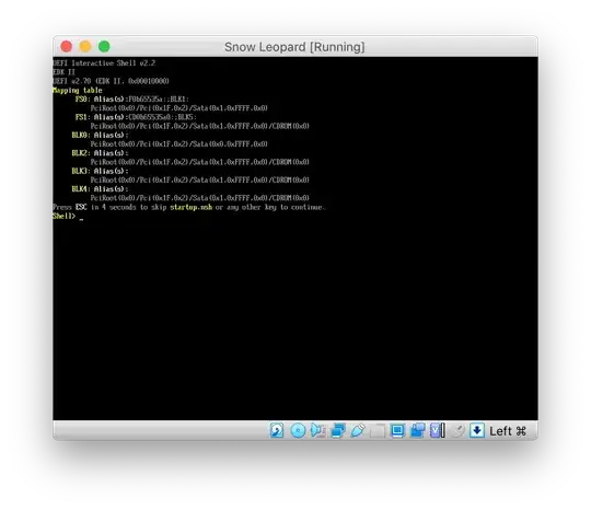

I am struggling to create a Mac OS X 10.6 (Snow Leopard) virtual machine on macOS 10.15 (Catalina). How can I use Snow Leopard in VirtualBox on macOS Catalina?
Here is what I have:
  • macOS 10.15.7 (19H1217)
    • Running on a MacBook Pro (Retina, 15-inch, Mid 2014)
  • VirtualBox version 6.1.22 r144080 (Qt5.6.3)
  • Max OS X 10.6 install ISO file
After initial setup, VirtualBox gets here and no further: enter image description here

You are correct. I am using an iMac (21.5 inch, Late 2013) with Catalina 10.15.7 and the same version of Virtual Box. I solved your problem by have the firmware boot from z file. I chose to boot from FS1:\System\Library\CoreServices\boot.efi.
The simple solution is to enter the following at the Shell> prompt.
I used a Snow Leopard ISO file created from a Snow Leopard OS X 10.6 DVD purchased from Apple. For more information, see this answer.
