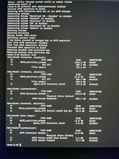

So i do : diskutil apfs deletecontainer disk1s2 Dummy
But I'm not sure to have what you explain. I haven't disk0s2
So I prefered to post you the diskutil list to be sure what I have to do next.
Diskutil list
Thanks again !

Below is a copy of the image you posted of your progress.
You entered the command given below.
You were suppose to enter the command given below.
You can fix this error by entering the commands given below.
diskutil addpartition disk0s1 jhfs+ "Dummy 2⁩" 0
diskutil addpartition disk1s1 jhfs+ "Dummy" 0
To insure the identifiers are assigned correctly, you probably should restart the Mac after entering the above commands. In your case, you will want to boot from the flash drive. Since you have successfully removed the defective APFS Fusion container, you can continue with the original instructions at the point where you will be entering the command which creates a new APFS Fusion container.

  • The image you posted shows you entered the command diskutil apfs deletecontainer disk1s2, but in your text you state entering the command diskutil apfs deletecontainer disk1s2 Dummy. The instruction to fix this error have been added to the end of my answer. See the section titled "Update 1". – David Anderson May 19 '21 at 05:44

  • @David In the container disk3 there is no data (840 kb) and the install key disk4 have not a valid partition scheme (guid is required for a boot disk). –  May 20 '21 at 05:58
