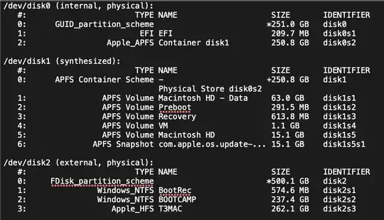

Computer: MBP 15 Late 2013. I have a BIOS booting Windows 10 installed on an external SSD. Windows occupies two partition on this SSD. The first is the System partition and the second is a combined Windows and Recovery partition. Below is the output from the command diskutil list.
Since I updated to Big Sur, I can not boot Windows from the external SSD anymore. I get a message that there is no bootable device and the computer restarts booting into macOS on the internal drive. It looks like Apple updated the boot loader (I can not tell from the new graphics), which appears to be connected to the issue. I have tried pretty much everything at this point and the only thing that lets me boot from the SSD is if I completely wipe/format the internal drive.
Is there a way to disable the internal boot drive so the boot loader doesn't see it? (I know this is a work around, but I don't have the time right now to further investigate the issue with the external SSD and why it can't boot from it.)
  • This is the disk I try to disable: Disk: /dev/disk1s5 geometry: 3811/255/63 [61228134 sectors] Sector size: 4096 bytes Signature: 0x0 Starting Ending

  • Yes, as mentioned in the original post, I'm focusing on disabling and not fixing the boot issue itself (I did some research and there are many other people with the same issue since the bootloader got updated). What I posted is the info on the partition that contains the OS (Big Sur). Not sure what the difference is between a volume and partition, but I do have a basic understanding of the other terms. I would like to hide the entire internal drive (disk0) or alternatively just the partition disk1s5 that contains the OS. Requested output --> https://paste.pics/C80XD – Cordvision Apr 16 '21 at 21:40

The firmware, stored on the logic board of your Mac, contains both BIOS and UEFI boot loaders. Additionally, the firmware on the logic board contains the Mac Startup Manager, which allows you to choose available startup disks or volumes. You can access the Mac Startup Manager by holding down the Option (⌥) or Alt key immediately after starting or restarting your Mac.
IFAIK, the the Mac Startup Manager can not be configured to to ignore the internal drive.
However, there exists other startup (boot) managers which can be configured to ignore the internal drive. One such free product is the rEFInd Boot Manager. To configure rEFInd to only search for BIOS booting external drives, one only has to add the following line to the end of the refind.conf file.
scanfor biosexternal
Furthermore, the rEFInd Boot Manager can be configured during installation to be accessible from the Mac Startup Manager. The rEFInd Startup Manager can be installed in your existing EFI partition, so you will not have to make changes to your external drive. If desired, rEFInd can silently BIOS boot windows installed on an external drive.
I used a 2013 iMac to verify your problem with the Mac Startup Manager exists. Next, I installed rEFInd to verify rEFInd would solve the problem. A more detailed explanation is given as an answer to the question Two Bootcamp installations: first one on Internal HDD and second one on external Thunderbolt 2 SSD.
