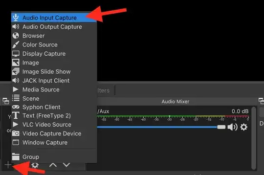

  4. In obs, in the "sources" section, add the first microphone as "Audio Input Capture".
    add Audio Input Capture source
    select your microphone
