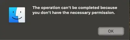

I am trying to copy a file to /usr/lib, but permissions are denied. SIP is disabled. When trying to copy via terminal, getting "Read-only file system".enter image description here

  • Well, in Catalina or later, yes, it would be a read-only filesystem. If you don't understand what that means, most likely you shouldn't be copying things into /usr/lib. – Marc Wilson Feb 01 '21 at 20:54

This is correct behavior. You should not under any shipping OS be able to paste to that directory.
Much better to use a script or PATH or environment variables to extend your library in /usr/local/lib or other locations intended for customization. The OS manages the /usr/lib/ directory so your files will get stomped the next time an OS update happens or cause other breakage.
