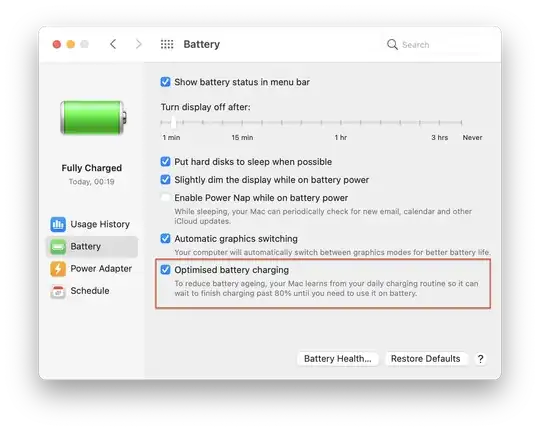

21
macOS 10.15.5 on a Mac notebook with Thunderbolt 3 ports has this option (even a bit smarter) embedded, see Optimised battery charging.
https://support.apple.com/kb/HT211094
System Preferences: Battery
grg
  • 201,078
Jarek
  • 396
  • 54
    Unfortunately, "even a bit smarter" is failing for me. The OS has yet to figure out when to stop at 80%, and I doubt it ever will (my routines are unpredictable) – Johannes Hoff Jan 07 '21 at 12:14
  • 26
    Indeed. Not very smart at all :) I would much prefer to have a manual setting, instead of having to rely on hacks like given earlier. – Faruk D. Nov 09 '21 at 14:09
  • If your 'routines are unpredictable', then that suggests you are actually unplugging it every now and again and using the battery, which means you don't need to keep it at 80% so much. By far a bigger factor in ageing is heat. – benwiggy Mar 06 '23 at 07:50
  • My routines are also unpredictable, but along the lines of draining it around 30% per week. I hardly use the battery, but this unpredictability has prevented Optmizing Battery Charging from reliably kicking in. Also, MacBooks are generally very good at keeping battery temperatures low despite the temperature of other parts of the laptop. – Oion Akif Jan 10 '24 at 04:57
    Case in point: here is my battery usage for the last two weeks. I hardly use battery power but that's enough to prevent Optimized Battery Charging from kicking in (which has always been enabled). – Oion Akif Jan 10 '24 at 05:09
  • Yeah, the OS seems really bad at handling if you unplug only occasionally, even after many months to learn — third-party software seems to be the way to go.  Having had batteries die in more than one previous MacBook, I'm happy to sacrifice 20% for longevity! – gidds Jan 19 '24 at 15:49
  • Same problem here on M3 MBP, the "Optimized" charger sometimes decides to charge it up to 100% and sometimes if it's at 100% it actually lets it run on battery down to 80% even though the charger is connected. It's like it can't make up its mind. I've only had it for 3 weeks though so maybe it's "learning" still.. – BjornW Feb 12 '24 at 09:37
