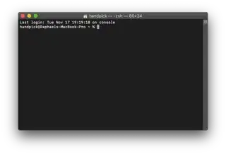

I am worried if this work computer may be infected with malware/trojan that the software was not able to detect and might be at risk of data breach. Can anyone advice please? Thank you so much! Code of the fileTerminal after restart (before restart it was showing ttysXXXX on the first lineTerminal after restart (before restart it was showing ttysXXXX on the first line)

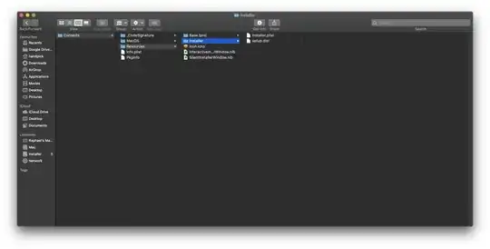

This is the content of the suspicious installer:
Contents of the installer

I'm assuming that the Terminal screen you're referring to is showing a login from a different TTY. (It's very difficult to see the Terminal prompt in the 4th picture). The script could have opened a backdoor to your computer.
