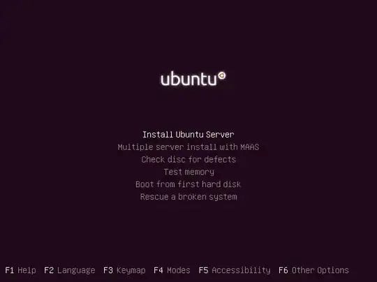

  3. BIOS boot from the DVD. Start up your Mac and immediately hold down the option key until the Mac Startup Manager icons appear. Insert the DVD and select to boot from the DVD icon with the label Windows.
  4. Install Ubuntu Server. When an image similar to the one shown below appears, you can choose for the installer to add the parameter nomodeset to the linux command line. This can be accomplished by pressing F6 and selecting nomodeset from the menu. With Install Ubuntu Server highlighted, press return to continue.

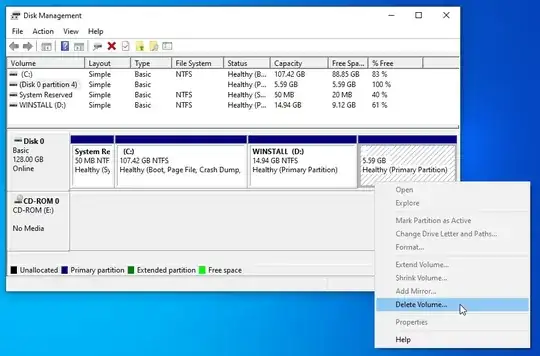

  12. Remove unnecessary partitions and extend the Windows 10 partition. Boot to Windows 10 desktop. Next, right click on the Start button and select Disk Management. A windows similar to the one shown below will appear.
    Right click on the last partition shown for Disk 0. Select Delete Volume…, as shown below. In the popup window, click on the Yes button.
    Right click on the free space shown for Disk 0. Select Delete Partition…. In the popup window, click on the Yes button.
    Right click on the partition with the volume label WINSTALL. Select Delete Volume…. In the popup window, click on the Yes button.
    Right click on the partition with the drive letter C:. Select Extend Volume…. In the popup window, click on the Next button. Again, in the next popup window, click on the Next button. In the next popup window, click on the Finish button.
    The result is shown below.

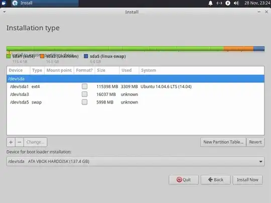

    Proceed with the installation of Xubuntu. For a brief moment during the installation, the following screen will appear with a warning message.
    The above screen will quickly be replaced by the screen shown below. Here the same warning message appears, but is partially covered.
    The intent is to install to the existing partition /dev/sda1.

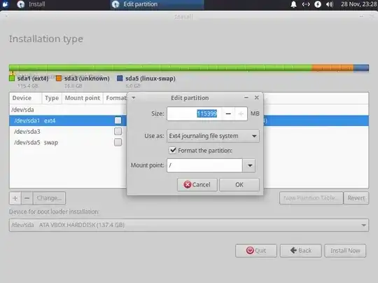

    Highlight the /dev/sda1 device, then click on the Change button. In the popup window, do not change the size value. Configure the rest of the controls as shown below, then click on the OK button.
    For this example, the result is shown below.

    Jerome: I chose ubuntu-14.04.6-server-amd64+mac.iso because you can burn this to a DVD and BIOS boot without the Select CD-ROM Boot Type: problem you posted in this question. You have been trying to fix a problem that Canonical (Ubuntu) solved over a decade ago. – David Anderson Nov 29 '20 at 03:15

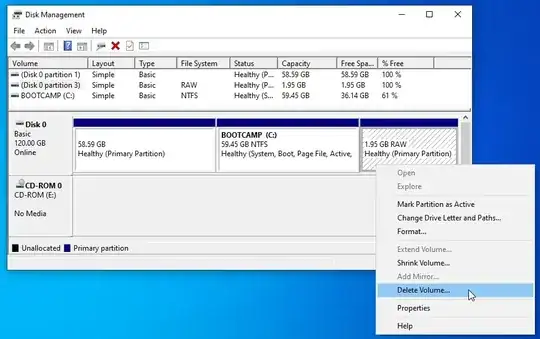

  1. Use the File Explorer to format the AVAILABLE volume. Below is an example image. Select the Start button, then select the OK button in the popup.

  9. Use the File Explorer to format the AVAILABLE volume. Below is an example image. Select the Start button, then select the OK button in the popup.
    format available

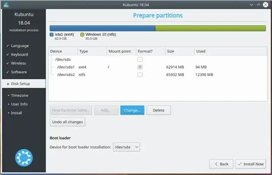

  3. Install Kubuntu. When the image below appears, select Manual, then select the Continue button.
    Installation type
    Highlight the /dev/sda1 device line, as shown below. Next, select the Change button.
    Prepare partitions
    In the popup window, leave the partition size unchanged and set the other controls as shown in the image below. When finished, select the OK button.
    Edit a Partition
    The results are shown in the image below. Next, select Install Now button, then the Continue button in the popup window.
    Prepare partitions
    Finish installing Kubuntu.
    before
    after
    For this example, the result is shown below. Click on the Install Now button, then click on the Continue button in the popup window.

  5. Remove the unnecessary partition and extend the Windows 10 partition. Boot to Windows 10. Use the Disk Management utility to delete RAW primary partition, as shown below. In the popup window, click on the Yes button.
    Exit the Disk Management application.

    Wonderful and stunning documented answer David. If I had the power to award you for the effort on the work here, I would make you Lord. – Jerome Dec 01 '20 at 21:00
    This is the answer that works for me. I would like to thank gratefully @DavidAnderson for his invaluable assistance, tests, researches. This is unique imho. Thanks David – Jerome Dec 04 '20 at 22:52
  • Feedback Part 1: originally two problems came up while attempting to install a Linux distro on this MBP. 1 - Cannot boot from USB, only from DVD live boot with 32 bit EFI boot / 2 - Debian cannot use the Radeon driver, and researches I made "undeniably" showed that was a kernel problem. So the alternative was to install Windows, with me having zero understanding of Windows combined with hybrid MBR and GPT. This explains why Windows came as the solution – Jerome Dec 04 '20 at 22:59
  • Feedback Part 2: David Anderson did a first very detailed answer with installing "ubuntu server 14.04 64 bit" using the DVD player. Out of curiosity, I tested booting from Live DVD Kubuntu 32 bits (could not boot using USB on any distros) and I installed Kubuntu with low pain. Now, considering this answer from David, I decided to mitigate my pain and concluded that i will not install WIndows. Instead I kept Kubuntu and installed Xubuntu as indicated in David's answer. Now, I can use this MBP as expected originally and learned quite a bit. Thanks David and ix07 for the help, both. – Jerome Dec 04 '20 at 23:24
