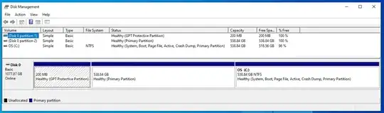

This answer assumes Windows is installed to BIOS boot. This can be verified by viewing the contents of the Windows Disk Management application window. Below is an example when Windows BIOS boots. Volume (Disk 0 partition 1) has a status of Healthy (GPT Protective Partition).
BIOS
Note: To get a better look at an image, either click on the image or open the image in a new window.
Below is what would appear when Windows EFI boots. Volume (Disk 0 partition 1) has a status of Healthy (EFI System Partition).
EFI
