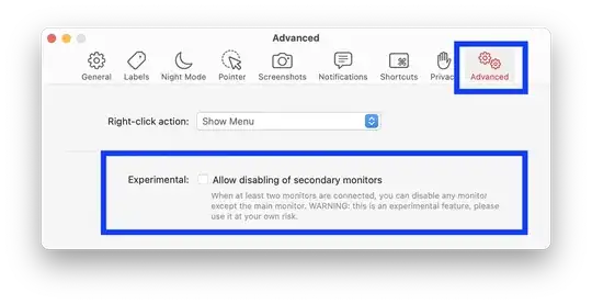

ISTR that there have been a few applications which have offered this as a minor, side, unsupported feature… but the only one I can recall/find now is Displays:
Just to be clear, here is how the developer describes this feature:
When at least two monitors are connected, you can disable any monitor except the main monitor. WARNING: this is an experimental feature, please use it at your own risk.
I am not 100% sure what is meant by “main monitor” but I am assuming that it means the monitor which has the menu bar/dock.
I have not tried this feature and therefore cannot speak to its effectiveness or safety from my own experience, therefore I can only echo the developer’s words: “use at your own risk.”
