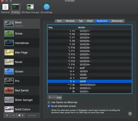

And hit control-u, the line gets wiped. If I type that line again, but then use option-left to skip a word back, then control-u doesn't wipe the line at all.
To begin with I was having trouble with option-right not skipping words forward. So I thought I fixed it with these terminal settings. But honestly I have no idea what these ascii codes do, and what state my terminal gets into.
Do ascii codes that skip words forward and back without breaking the terminal exist? What are they?
mac terminal keyboard settings

I found a lot of clues here: https://coderwall.com/p/a8uxma/zsh-iterm2-osx-shortcuts
This is what I put in my .zshrc to fix things.
bindkey "\033f" forward-word
bindkey "\033b" backward-word
bindkey "\033[H" beginning-of-line
bindkey "\033[F" end-of-line
Alongside these terminal keyboard settings:
MacOS default terminal keyboard settings
For some reason, the control (^) key modifier can be set, but does not activate the codes in the terminal. So I'm only using option and shift.

Initially I used whatever key codes I wanted. That was a mistake, because even though they worked on my local mac, they didn't work when I SSH-ed into a linux machine. Using less /etc/inputrc on the remote bash I found these existing shortcuts:
# allow the use of the Home/End keys
"\e[1~": beginning-of-line
"\e[4~": end-of-line
mappings for Ctrl-left-arrow and Ctrl-right-arrow for word moving
"\e[1;5C": forward-word "\e[1;5D": backward-word "\e[5C": forward-word "\e[5D": backward-word "\e\e[C": forward-word "\e\e[D": backward-word
Also, my local bash had different settings. To find those out I used
bash-3.2$ bind -p | grep of-line
"\C-a": beginning-of-line
"\eOH": beginning-of-line
"\e[H": beginning-of-line
"\C-e": end-of-line
"\eOF": end-of-line
"\e[F": end-of-line
Which made me settle on the terminal keyboard settings you see at the top. Because they worked in all 3 settings (local zsh, local bash, remote bash).
