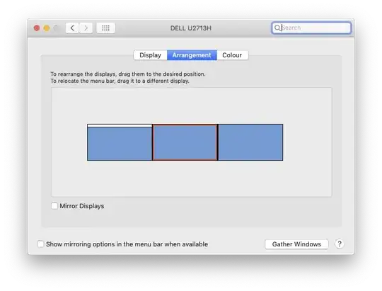

In the meantime, a workaround would be to re-arrange your display order in System Pref > Displays > Arrangement.
You can drag individual displays into whichever order you would prefer.
If you click & hold any display it will highlight in red - on the control panel & also right round the display that is referenced, so you can easily tell which is which. The primary display is the one with the menu bar [which can also be moved, if needed]
Image showing 3 monitors, centre highlighted, primary assigned to left-most.
If your Mac is suffering from this 'forgetfulness' you may need to re-do this each time you change your connected monitors [hence the need for the app mentioned above.]

    You are correct it is not a duplicate of the linked question and I had run across that one as I was researching the issue. Your suggestion sort of works and if I slightly rearrange them so that they are no longer all lined up the order corrects itself to be 1, 2, 3. I even tried completely redoing the order by moving everything around and redoing it. However the issue is that if I fix the alignment to better match them up it switches back to 1, 3, 2 but if I move it just slightly out of alignment it reverts back to 1, 2, 3. While this isn't ideal it should until I can find a better fix. – Joe W Aug 09 '20 at 14:33
