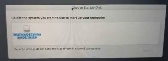

When I was going to reinstall a fresh copy of macOS Catalina on my MacBook Pro (16-inch, 2019), unfortunately I deleted all partitions instead of erasing them. As my internet connection is so unstable as much as I repeated installing the OS from the net, it was failing with different errors usually related to the network errors or usually it says can't decode raw data.
I created a bootable media flash drive by these steps https://support.apple.com/en-au/HT201372.
Now when I want to boot the device from the USB drive, Choose startup disk
it says "Security settings do not allow this Mac to use an external startup disk". Security settings do not allow this Mac to use an external startup disk

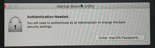

I waned to allow my Mac booting from external media (as this link https://support.apple.com/en-au/HT208198) but It shows me the error: "Authentication Needed - You will need to authenticate as an Administrator to change the boot security settings."
And when I click on Enter macOS Password I see this error : "Recovery is trying to change system settings. No administrator was found."

bmike
  • 235,889
  • Sounds like you have a firmware password and you don’t remember choosing one? I’ll answer on the assumption that’s the dialog you have. – bmike Aug 02 '20 at 12:49

The disk (that you erased) contains a 'Secure Token' for the admin user. You need to recreate it before you can change the settings.
First, reinstall the OS using Internet Recovery. Or install over Target Disk mode from another Mac.
The Setup Assistant on first boot will provide the Secure Token for the admin user created. Otherwise, you'll have to manually create the token for the admin user once you've got a working system.
sysadminctl interactive -secureTokenOn [admin user shortname] -password -
(you will be asked to authenticate).
diskutil apfs updatePreboot /
See this answer, which covers much of the same ground.

I am going to guess you ended up with a firmware password and aren’t seeing the images here due to some removals of OS that the system expected.
If so, you will need to get Apple to unlock the device by providing original proof of purchase if you can’t recall and enter the passwords that were entered into the T2 / Secure Enclave. The T2 encrypts the storage with a device key and as you add admin accounts, their password and identity is asssociated with the key to unlock the storage so you would normally provide that admin password to retrieve the key to make a change. This doesn’t really need an admin user - just one authorized to perform the storage unlock and change the boot sequence. Typically that’s an admin since typically only one account is on a Mac out of the box.
The good news is your hardware is fully capable of internet boot, so I would try recovery from the internet to drop on macOS and see if you can unlock and configure things with a new OS from Apple being trusted and installed.
Supporting Macs at work, we override all three of the items in the KB you reference with Internet Recovery and an erase. For firmware passwords, unless we have an MDM unlock, we do go to Apple service for that just like consumers do in the end, but it’s rare we lose control of most devices in that manner. Hopefully you get a trusted install from the internet and can reinstall Catalina without using USB.
