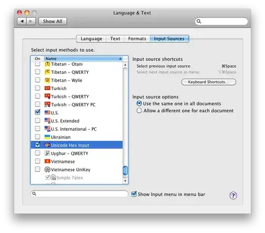

There's a way of entering Unicode values on the Mac: go to System Preferences, then Language & Text. In the Input Sources tab, scroll to Unicode Hex Input, check it.
Select Unicode Hex Input from the list of Input Sources in the Language & Text preference pane.
Then if you switch to Unicode Hex Input in the Mac menu bar, you can press
+2212 for the minus sign. Here's what the input switcher looks like:
Input switcher in the Mac menu bar.
If you want to switch between your input and hex input via keyboard, you have to click "Keyboard Shortcuts..." in the same window, disable "Show Spotlight Window" in the Spotlight section, and maybe activate "Select next source in Input Menu". ++space will then swap input language. (You can check this in the menu bar.)
