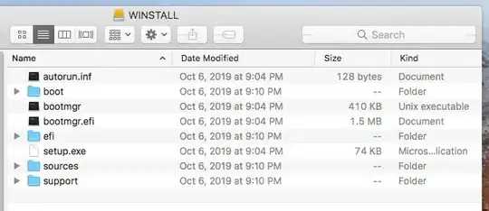

  3. User Finder to mount Windows 10 ISO and copy the files to WINSTALL. When finished unmount the ISO. Below is what appeared on my WINSTALL volume.

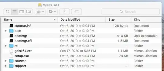

  5. From the gdisk download, copy the file gdisk64.exe to WINSTALL. Below is what appeared on my WINSTALL volume.
