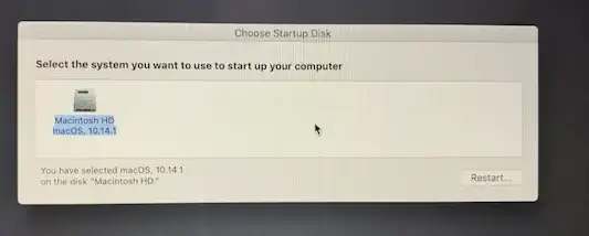

Without internet, the message below shows up: enter image description here
When I click "Startup Disk" the EFI boot does not show up and all I can select is my Macintosh HD.
enter image description here (this image is from a forum, my Macbook is up-to-date, MacOS Catalina 10.15.4)
Googling up I found this could happen because of T2 chip securities, I disabled all of it's securities in recovery mode. The problem persists. What may be causing this issue? How can I fix it?

I am having this exact same issue following the exact same Ubuntu Tutorial. Have tried a multitude of variations with the security settings...but nothing helps and after it's downloaded something (approx 70%-ish?) the screen goes black, comes back on with Apple logo and boots into my regular Mac HD.
My supposition is the process breaks the OS and we have to follow a different path to run this software.
EDIT: To add, and an FYI, following the same Ubuntu tutorial from above, but now for a bootable DVD instead, gives the same 'error' loop. It appears (to me at least) that any kind of external media, whether that be USB flash drives or DVDs/CDs, currently aren't supported by the Boot manager under MacOS (Catalina: version 10.15.6) despite lowering/altering the T2 chip's security settings.
EDIT 2: as Topic starter mentioned below, 2019 Macs do not support alternative OS other than Windows for now. Thanks for all your insights and let's hope someday Ubuntu will also be supported.

  • I later found out that the MacBooks 2019 do not accept OSs but Windows 10. So installing any Linux on it breaks the system. – RA828 Aug 15 '20 at 14:40
