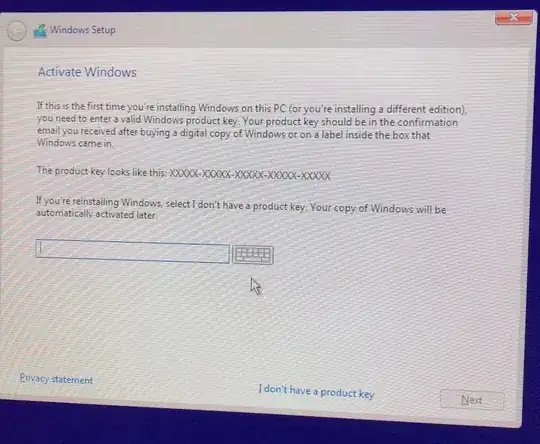

I was able to recreate the problem shown in the image you posted. Apparently, at least the driver for the internal drive has to be loaded from the WINSTALL volume before the dism command will work properly. I update the instructions so you will proceed with the GUI steps for installation until the window below appears.
At this point, the drivers have loaded, so you can proceed and open a Command Prompt window and start entering commands.

To open a Command Prompt window, you are suppose to press the shift and F10 keys at the same time.
You copied the WindowsSupport folder to the WINSTALL volume. The instructions in step 4 stated to copy the contents of the WindowsSupport folder to the WINSTALL volume. The $WinPEDriver$ and BootCamp folder should appear in the root folder of the WINSTALL volume, as shown below.
