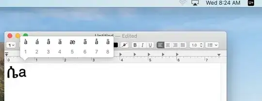

With Ukelele I was able to make a copy of the Unicode Hex input source and add the "en" language to the bundle format. This seems to have created a version of Unicode Hex with a working popup, as shown below. Modifying the popup would be a separate operation with the pressandhold.app.
The image shows the input source used both for Option 1234 (= U+1234, Ethiopic SEE) and the press/hold letter a. I have not tested it in more detail. A copy can be obtained here .

  • That sounds like the direction I was fiddling with. Ukelele has a merging feature? I’m still reading the very large manual … – WGroleau Feb 12 '20 at 17:18
  • I don't know what you mean by merging. It has feature to duplicate existing keyboards. The popup menu contained inside the pressandhold.app can apparently be accessed by using the bundle format and giving the keyboard an appropriate language parameter. Ukelele manual section 5.6 – Tom Gewecke Feb 12 '20 at 17:40
  • I see that page fourteen in the manual has “support for press-and-hold” which wasn’t mentioned in the tutorial. – WGroleau Feb 12 '20 at 17:52
  • Taking this as the answer, though I intend to finish reading the manual and trying to do it myself. – WGroleau Feb 12 '20 at 18:01
