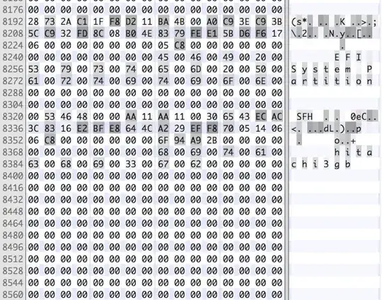

The drive was originally formatted with a single partition using Mac OS X Snow Leopard. I found the HFS+ partition type GUID while scanning through the data in the hex editor, Hex Fiend: 53746F72-6167-11AA-AA11-00306543ECAC (Apple Core Storage Container HFS+ FileVault volume container). This was followed by the 1st EFI part entry is at offset 4096: HFS GUID, EFI part
The 1st EFI system partition is at offset 8192: EFI/GPT
I attempted to extract the GPT/EFI and HFS partition information from the above image:
06 00 00 00 00 00 00 00 = 6 (start of EFI).
05 C8 00 00 00 00 00 00 = 51205 (end of EFI).
06 C8 00 00 00 00 00 00 = 51206 (start of HFS).
6F 94 A9 2B 00 00 00 00 = 732533871 (end of HFS).
The secondary EFI system partition at offset 3000592957440 appeared to contain the same start and end values, and the secondary EFI part entry was at offset 3000592973824.
The 1st HFSJ entry was found at offset 209740800: HFSJ
The total # bytes given by diskutil info is 3000592982016: diskutil info
If the HFS main volume size is 732533871 - 51205 = 732482666 blocks, then the logical block size should be 4096 (which gives total # blocks on disk = 732566646). Although a 512 byte block size was given by diskutil info (above image).

  • Are you sure you executed the commands sudo dd if=/dev/zero of=/dev/disk2 bs=512 count=40 and sudo gpt create /dev/disk2? I ask because to recreate the results you posted, I would have to execute the commands sudo dd if=/dev/zero of=path/to/file.dmg bs=512 count=40 and sudo gpt create path/to/file.dmg. – David Anderson Jan 26 '20 at 21:36
  • @DavidAnderson, Thank you for your answer. I will try it as soon as I re-create the full disk image file (it should take a couple of days to make another copy of my original to work with). You are correct that I actually ran those commands on the image rather than the device. I'll be sure to run them on the device next time following your instructions. Would 'gpt destroy disk2' still work as intended if the GPT utility can't detect the GPT headers (when I ran 'gpt recover', it gave 'no primary or secondary GPT headers, can't recover')? – Leslie Jan 28 '20 at 00:34
  • When I was testing the steps you posted in your question, the command sudo dd if=/dev/zero of=/dev/disk2 bs=512 count=40 was not sufficient enough to be able to execute sudo gpt create /dev/disk2. I assume the reason for this was there still existed a secondary GPT at the end of the drive. The sudo gpt destroy /dev/disk2 command was required. Using gpt destroy before gpt create may not alway be necessary, but entering the command should do no harm. – David Anderson Jan 29 '20 at 00:27
  • @DavidAnderson- Unfortunately the step gpt destroy /dev/disk2 gave this message: gpt destroy: /dev/disk2: error: device doesn't contain a GPT . So I may have to try using the dd option. I realized in my initial attempt I neglected to include conv=notrunc , which I'm guessing is what truncated the image. To use dd to overwrite the primary and secondary GPT, how much of the end of the disk image would you recommend I overwrite with zeros (just the secondary GPT or everything after the HFS main volume)? – Leslie Feb 04 '20 at 02:54
  • You should have ignored the error message and proceeded to enter the gpt create /dev/disk2 command. I tried to indicate the gpt destroy /dev/disk2 command may not be necessary. – David Anderson Feb 04 '20 at 04:45
  • "Interestingly the 3rd partition contained a disk read error at offset 3000582140288". The strings visible in the "NTFS header" are standard warning messages. So no disk read error ;-) – klanomath Feb 04 '20 at 06:43
  • @DavidAnderson- It is mounted and working. Many, many thanks for your help and your guidance throughout this process. There was one small change to the posted answer that I had to use: diskutil mountDisk /dev/disk2 , rather than diskutil mount /dev/disk3 . – Leslie Feb 05 '20 at 03:16
Based on the latest information posted in the question, here is what to enter. The assumption is the values posted are correct. The drive used a 4096 sector size. Since image files are fixed at a 512 byte sector size, all the values need to be multiplied by 8.
Note: You may get an error message when entering the command to destroy the GPT. You should ignore this message.
sudo chown $USER:staff path/to/file.dmg
hdiutil attach -nomount path/to/file.dmg
gpt destroy disk2
gpt create disk2
gpt add -i 1 -b $((6*8)) -s $(((51205-6+1)*8)) -t efi disk2
gpt add -i 2 -b $((51206*8)) -s $(((732533871-51206+1)*8)) -t hfs disk2
diskutil mount disk3
The GPT you posed has a partition type GUID for Core Storage, but the header you posted for this partition indicates the partition type GUID should be for a Hierarchical File System Plus (HFS+) partition. My answer assumed the header is correct.
