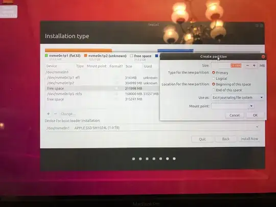

Here are my screenshots of some of the key steps I followed in that answer (from above):

steps 08-13
steps 08-13 steps 08-13 steps 08-13 steps 08-13 steps 08-13 steps 08-13 steps 08-13 steps 08-13 steps 08-13 steps 08-13
steps 15,16
steps 15,16 steps 15,16 steps 15,16

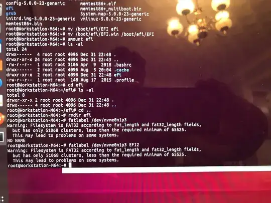

Below is a copy of an image you posted as part of your question with respect to steps 15 and 16.
The image shows the following message.
Warning: Filesystem is FAT32 according to fat_length and fat32_length fields,
  but has only 51068 clusters, less than the required minimum of 65525.
  This may lead to problems on some systems.
This warning occurred because the drive on your Mac has a sector size of 4096 bytes. However, the answer referenced an example Mac with a sector size of only 512 bytes. In other words, the new EFI partition you created was too small. The instructions have been changed so the new EFI partition is at least as large as the original EFI partition. In your case, this should be about 315 MB.
To create a larger new EFI partition, you will have to reinstall Ubuntu.
