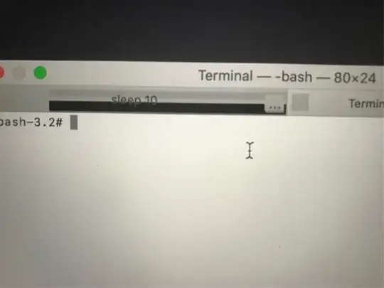

The Macbook does not spontaneously shut down or restart when I boot it into Recovery Mode or Safe Mode.
However, there are also graphical glitches in both of these modes; look at the terminal tabs in Recovery Mode:
Moving the mouse cursor over the tabs causes them to scintillate randomly, rectangular monochrome patterns. and glitches.
Exactly the same graphical glitch happens to Finder tabs in Safe Mode.
