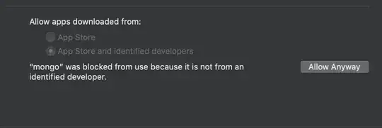

I updated to Catalina 10.15.2 from 10.14.X and the new security failed to recognize mongo as a trusted developer. Trying to run mongod in terminal triggered a system dialog (popup) refusing to run mongod with no option to override it.
System Preferences > Security & Privacy > General has a section at the bottom for app developer identity settings and also reports any recent related service denials. This is where you will find the coveted Allow Anyway button:
an alert about the recent refusal to trust that service and a button to allow it
Click that and run mongod in terminal again. You'll get a new security dialog with an Open button. Click it and mongo is back in the trust circle.
new alert with option to run the unrecognized mongo software
