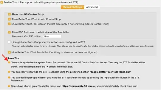

Unfortunately I do not have a touchbar Mac to test, but it seems like BetterTouchTool is able to do what you want:
n1000
