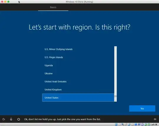

    Next, select "OK" to shutdown the Mac. At this point, you have completed the installation of Windows 10. If you have not already done so, you can remove the flash drive.
    Note: If you initially prohibited your Mac access to the internet, you may now want to allow access before turning your Mac back on. In other words, plug in the ethernet cable or turn the Wi-Fi back on.
    Next time you turn on your Mac, Windows will start in the "Out of the Box Experience" mode. This is basically the way a newly purchased PC starts up, when Windows 10 is already installed.
    Note: When asked, be sure to select an Apple keyboard.
If asked, I can clarify any of the above steps
