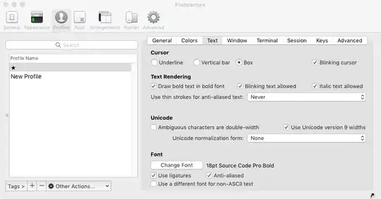

If your using Terminal or iTerm you can go to preferences and look for option to change fonts. For iTerm its shown in the image below.
If you click on the change font button you get the following pane.
As you can see in this image there are sliders to adjust the character spacing. you can spread the characters out on the iTerm windows.

    Yes, I am aware that option exists in the terminal menu, but it doesn't have anything to do with the issue I'm suggesting. All that does is increase the width of each cell in the terminal. It does not change in any way how many whitespace characters are printed.
    On the other hand, the issue I had is with the number of whitespace characters printed. Specifically, when you run ls -G it outputs fewer whitespace characters than ls because it changes tabs to a single space.
    – Tristan Apr 14 '19 at 03:24
