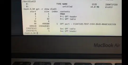

From here it flagged up the error: “gpt add: disk0: error: no space available on device” but I moved on to the second section because the guy in that post said that it solved his problem.
diskutil list
gpt -r show disk1
(I do no have the pictures for these)

I only did the first two as the diskutil list only showed two.The first was created fine but the second flagged up the error: “gpt add: disk0: error: no space available on device”. Even still I went ahead and rebooted to see if anything happened and obviously nothing did.
From here I am apprenhensive to go on with the things I have seen from searches. Here is what ”diskutil list” shows now:
Strangely the internet recovery seems to have flipped to disk0 while the mac drive is now on disk1. Here’s what “gpt -r show disk1” returns:

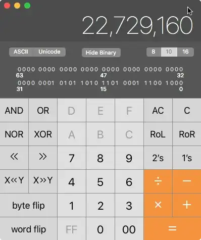

    For the record: the reason the second gpt command failed ("error: no space available on device”) is that the partition size (-s 372637568) was bigger than the drive. The first partition's parameters and the beginning sector number of the second partition are pretty standard, but the second partition's size will vary depending on the size of the drive and how it's partitioned. Your drive is a different size than the one in the linked question, and also partitioned differently, so that parameter will not work on your system. – Gordon Davisson Mar 08 '19 at 00:17
  • It might be possible to figure out the correct size for your macOS partition, adjust the second gpt command appropriately, and get back to working. But if you get it wrong and the gpt command doesn't reject it outright, you could easily make things even worse. At this point, I'd recommend handing it off to a DR professional. – Gordon Davisson Mar 08 '19 at 00:19
  • @GordonDavisson Ah so that didn't work because of the size? Does the EFI also have to be a certain size as well or is that always set at 409600? I think I have a photograph which I took of the Macintosh HD partition from the Try Ubuntu disk utility which had the size of the Macintosh HD partition after extending it into the previously Linux space using that utility in bytes. I'll add that to my post if I find it. – Mcvith Mar 08 '19 at 13:02

The third line, in the output you posted, shows the letters NXSB. This is a good indication that a APFS partition once resided at offset 409640. The hexadecimal sequence c8 d1 5a 01 00 00 00 00 appears on the same line. One can enter, into the Calculator application, these hexadecimal pairs in reverse order, as shown below.
This value can be converted to decimal by clicking on the 10 button. The result is shown below.
Next, one can click on the x8= buttons to multiply by 8. The result is shown below. This is the value you should have used for the partition size instead of 372637568.
Note: This step was required because your sector size is 512 bytes. This step can be skipped when the sector size is 4096 bytes.
This what you entered:
diskutil umountDisk disk0
gpt add -i 2 -b 409640 -s 372637568 -t 7C3457EF-0000-11AA-AA11-00306543ECAC disk0
This is what you should have entered:
gpt add -i 2 -b 409640 -s 181833280 -t 7C3457EF-0000-11AA-AA11-00306543ECAC disk0
