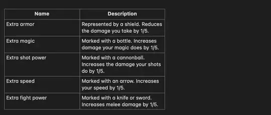

I was initially confused that adding space characters to the end of the line did not increase the width of the column as others have said. It turns out that you have to add more space characters than you may assume in order for the column to grow.
Here is some experimentation with a table cell that I want to be displayed using a single line of text. By adding 20 space characters to the end of the text, the cell/column begins to grow. But it takes 47 space characters to eventually make the cell/column wide enough to fit the cell's text in a single line.
three cells with increasing space counts
