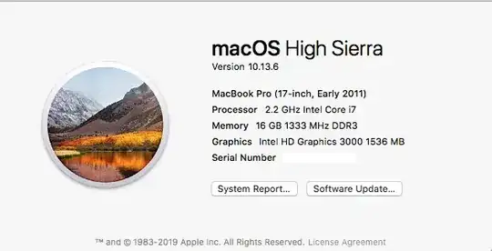

Well, after my Discrete GPU failed for third time, I decide to eliminate it from the system, and followed the instruction from LangLangC in:
GPU problem - Boot Hangs on Grey Screen
All works fine except when opening applications that need GPU acceleration, like Photos.
In that situations glitched zones appear on the screen until the application quits.
Will upgrading RAM provide more shared memory for the HD Graphics 3000 to access?
At this time, after hack the shared memory to the GPU reached 1536 MB, as is shown in About This Mac.
The Terminal commands for this are:
Add more VRAM
@arqueox try these steps they 100% work this time to increase from stock 512 MB to 1536 MB VRAM:
cd /S*/L*/Ext*/AppleIntelSNBGraphicsFB.kext/C*/M*
sudo cp AppleIntelSNBGraphicsFB AppleIntelSNBGraphicsFB.backup
sudo perl -pi -e 's|\xC7\x45\xD0\x00\x00\x00\x20|\xC7\x45\xD0\x00\x00\x00\x60|g' AppleIntelSNBGraphicsFB
sudo touch /S*/L*/Extensions
Thanks to @arqueox for having tested the Info.plist before reboot/restart you have to edit this file:
/System/Library/Extensions/AppleIntelHD3000Graphics.kext/Contents/Info.plist
Adding after these strings, this part:
<key>VRAMMethod</key>
<integer>0</integer>
<key>VRAMOverride</key>
<key>VRAMSize</key>
<integer>1536</integer>
After edited the plist from Terminal type:
sudo chown -R 0:0 /System/Library/Extensions && sudo chmod -R 755 /System/Library/Extensions
sudo kextcache -i /
sudo reboot

Adding extra memory to the system is not going to improve the graphics, I'm afraid.
The Intel HD3000 has a hardware limitation of approx. 1.7 GB of system RAM it can use for video ram. So even though you add 8 GB of extra system RAM, you're not going to be able to use more of it for video ram.
As far I know it is possible to set the VRamSize to 2048, which would indicate 2 GB - but in reality only ~1.7 GB would actually be used.
If you want to try that, please change the x60 in your command to x80, and the VRAMSize from 1536 to 2048.
I wouldn't expect that to alleviate the problem with zones of glitches however.

  • Thank a lot. I will try this and will tell you what happens – Francisco Javier Dominguez Rog Feb 09 '19 at 16:18
  • Hello: I do that but maintains 1536 Mb. Comparing to my iMac 2013: It have 8 Gb RAM as well. And shares 1536 Mb to the Iris Pro.
    I thing must Upgrade to 16 Gb to reach 2 Gb of shared VRAM.
    Regards
    – Francisco Javier Dominguez Rog Feb 10 '19 at 15:07
  • I don't think upgrading to 16 GB will help at all, I'm afraid. – jksoegaard Feb 10 '19 at 21:25
  • Hello to all: Well, after test my MBP y different conditions, may say not all is lost.
    Reviewing the RAM behavior, happens scenarios when RAM is out, and all it is paginated to Virtual in the disk.
    Then, add RAM obviously will increase the speed and left enough video RAM to the HD 30000.
    Adding to this, if I install a SSD, the virtual RAM will operate almost physical.
    Then, I will try that and tell you all what happens.
    Regards
    – Francisco Javier Dominguez Rog Feb 14 '19 at 19:28
  • Ah, you haven't given us that important information that you have everything swapped out. In that case extra RAM is obviously going to help a lot with system performance in all kinds of ways. – jksoegaard Feb 14 '19 at 19:46
  • Hello:
    Appears a KERNEL PANIC..... associated to the GPU. Well, can't find the PCI GPU and restart after plug my iPhone in when my MBP is in Sleep.
    – Francisco Javier Dominguez Rog Feb 20 '19 at 14:37
  • Hello: After follow the instruction to solve the problems about over heating ( the Mac think the AMD is working in background ). This have a second behavior about the Power Management.
    The Kernel Panic was product of this.
    Then remove the command line .sh and all works fine again.
    For example, can open VectorWorks without major issues.
    – Francisco Javier Dominguez Rog Feb 22 '19 at 12:47
I want add a new update to this. In some Logs around the web, talk about the lost of Sleep, Wake up, And other issues.
This happens after remove ALL AMDKexts without take a little step to think.
The only kext must be removed from the system is AMDRadeonX3000.kext And putted in a folder called: Extensions_Off
After that must run for example: Kext Utility to fix the permissions and the extensions cache.
running 16 Gb RAM
Another important issue: Try to operate with 2048 Mb shared RAM do not work. My Mac at less, start as connected to an external display. With ALL THE RAM SHARED TO VIDEO. Then all became slow.
Regards
