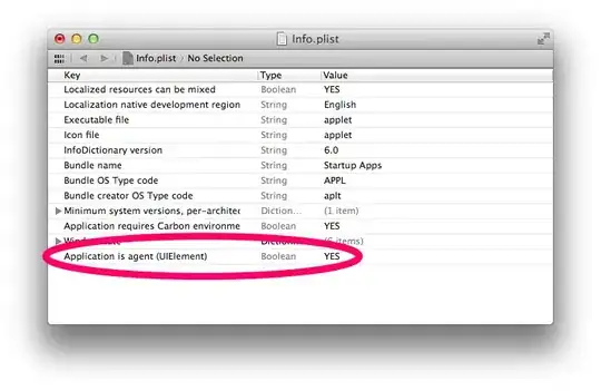

  4. Right-Click on the created application and navigate to .../Contents/Info.plist It will open in Xcode.
  5. Menubar -> Editor -> Add Item
  6. Select: Application is agent (UI Element): YES and save. enter image description here
