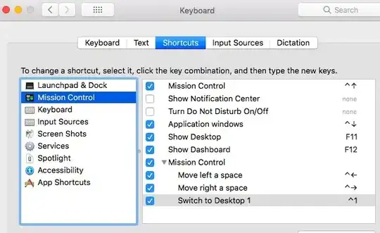

Say, I have 10 desktops. I'm on the desktop 2. I switch to the deskotp 7 using the F3 key and touchpad. Is there a standard hot key for switching back to the deskotp 2? And then back to the deskotp 7.
Similar to Alt+Tab, but for the desktops.

  • Do the opposite of this - https://apple.stackexchange.com/q/214348/85275 then ctrl/left or right will toggle between the last two - though you will lose your numbering. Alternatively, use ctrl/number to access directly. – Tetsujin Dec 06 '18 at 16:42
  • @Tetsujin that's already done – nylypej Dec 06 '18 at 16:45
  • Then go back to that answer & use direct numbers instead. There's no command for 'last used space', though Cmd/Tab would do the equivalent if you have your Spaces set correctly. – Tetsujin Dec 06 '18 at 16:48
  • If you know which desktops you want to switch to just use they numbers i.e ctrl 2, ctrl 7, ctrl 2 ... – Ruskes Dec 06 '18 at 16:53
  • One thing to note is that if you have an extended keyboard with a 10-key, even though they look the same in prefs, those keys are actually different from the ones above qwerty. The default key commands use the qwerty keys. – Tetsujin Dec 06 '18 at 17:00
  • @Buscar웃 doesn't work – nylypej Dec 06 '18 at 17:03
  • @Tetsujin I don't ask about the direct numbers – nylypej Dec 06 '18 at 17:04
  • What do you mean it does not work ? did you enable it in the system preferences > Keyboard shortcuts > Mission Control ? does it show all your desktops there with numbers associated ? – Ruskes Dec 06 '18 at 17:07
  • I know you didn't ask about the direct numbers.... but what you want cannot be done directly by key command... so we're trying to figure out an alternative for you – Tetsujin Dec 06 '18 at 17:07
  • @Buscar웃 & nylypej - the key commands are not enabled by default. You need to specifically switch on each one in system prefs>keyboard>shortcuts>mission control. – Tetsujin Dec 06 '18 at 17:09
Using keyboard shortcuts to switch Desktops.
Open System preferences > Keyboard > Shortcuts.
Click on the Mission control.
Desktops will show there with number associated to it.
Check all you want to switch.
Use "ctrl" and press number to switch.
