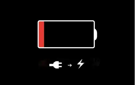

Yesterday my MacBook shut down, a few seconds after I turned it on, and showed this screen when I wanted to turn it on again:
Mac low battery screen icon
When I plugged in my Mac, the battery level was at 100%!
The same scenario happened today when I turned on my Mac, it was showing around 20% battery left and a few seconds after I logged in, it shut down and was showing the same low battery screen.

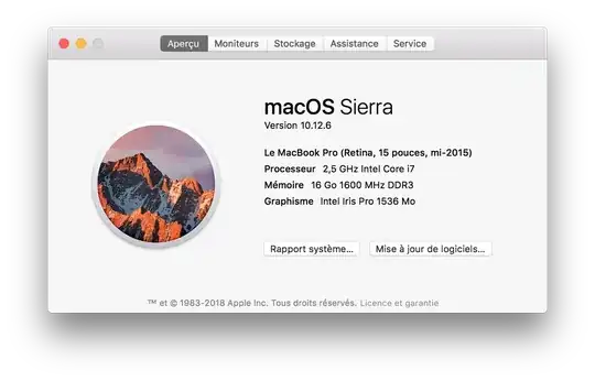

I have a MacBook Pro mid-2015 with macOS Sierra.
About This Mac

Your battery is failing; it's not holding a charge It's time to have it replaced.
The symptoms you've described is indicative of one or more failed cells. Your battery is going to "report" back to the SMC that it has:
  • 7496 milliampe hours at full charge
  • 3113 milliampe hours remaining (calculated value)
  • 451 charge cycles
  • it's putting out approximately 12.3 volts (measured value)
As much as it can measure at a single point in time, it cannot "look into" the battery to see if there's capacity to hold a charge - in other words, there's no "dipstick" to measure capacity within the cells themselves.
When there's a bad cell, your charge will go from "good" to "bad" with no warning (i.e. 20% to nothing) because it cannot account for the missing capacity.
Also, given the age of the MacBook (3+ years) it's well within it's lifespan of 3 to 5 years.
Allan
  • 101,432
  • Thank you very much for your answer! My MacBook is 2 years old by the way. Regarding the number of cycles (out of the maximum cycle count (1000)) it may makes sense to me that the battery would begin to show some malfunction. I will consider replacing my battery then. – Maël Nov 14 '18 at 21:12
  • Cycles isn't the only thing, it also age. I've had batteries last only 18 months and some last the better part of a decade and everything in between. That said, age and number of cycles don't discount manufacturing defects. Remember, these are chemical reaction based products - there's going to be variances. – Allan Nov 14 '18 at 21:14
  • I was about to ask if cycles were the main problem here ; is it more like an accumulation of normal deterioration due to usage? – Maël Nov 14 '18 at 21:18
  • Most likely, it's nothing you've done (unless you're using it in super harsh conditions like the desert or the arctic) it's a combination of cycles, age and manufacturing. See this post for a more detailed answer: https://apple.stackexchange.com/a/238125/119271https://apple.stackexchange.com/a/238125/119271 – Allan Nov 14 '18 at 21:32
