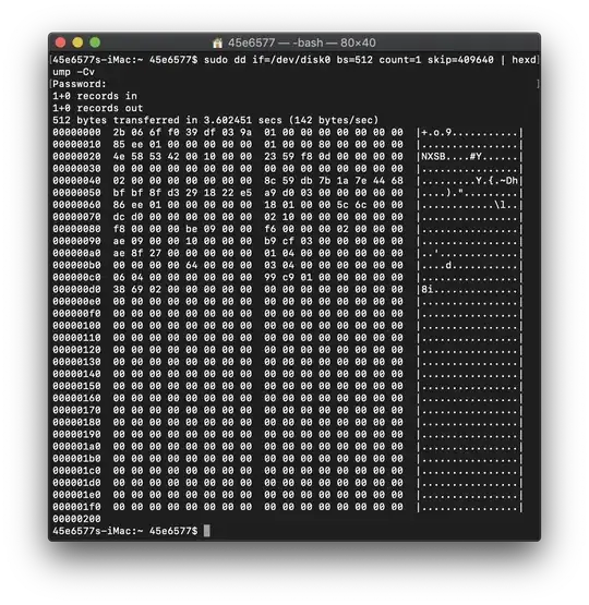

sudo dd if=/dev/disk0 bs=512 count=1 skip=409640 | hexdump -Cv

  • Could you provide the output from the following command? sudo dd if=/dev/disk0 bs=512 count=1 skip=228482040 | hexdump -Cv – David Anderson Oct 20 '18 at 05:56
  • @DavidAnderson I followed this guide https://www.maketecheasier.com/install-dual-boot-ubuntu-mac/, I will insert the output of that command in my question. – user306251 Oct 20 '18 at 15:16
Note: Posting images of the output from the Terminal application can often lead to users not posting an answer to a question. You should copy and paste the text to your question. Once pasted, highlight the text, then click on the code sample button {} to format the text.
Your current APFS partition (disk0s2) does not appear to be valid for several reasons. Below are three reasons.
  1. The magic number stored in the header is incorrect. Also, the header defines the block size to be 2,385,839,421 bytes and the APFS container to be 2,777,634,813,198,357 TB in size. The magic number should be BSXN. The block size should be 4096 bytes and the container should be less than or equal to 883,222,061,056 bytes in size.
  2. The APFS partition size of 1,725,043,095 logical sectors is not divisible by 8.
  3. The APFS partition should appear either immediately and soon after the EFI partition (disk0s1). Here, the partition starts 116,773,068,800 bytes after the end of the EFI partition.
It appears that an APFS partition of 960,018,657,280 bytes in size did occur immediately after the EFI partition (disk0s1). The problem is the data stored in the APFS partition was partially overwritten by the data now stored in disk0s3. The type and location of disk0s3 would indicate that macOS Sierra may have been installed close or immediately before disk0s3. If this is true, then additional data stored in the APFS partition may have been overwritten.
Note: The partition entries stored in the GPT are not in ascending order. While this does not create problems for Ubuntu, this condition oftend leads to an incorrectly functioning macOS.
