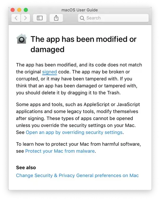

I am trying to publish a signed application, but when downloading it through internet, gatekeeper complains:
Furthermore, the help page says that the app has been tampered with:
Which is actually not true, here is my signing/packaging procedure:
